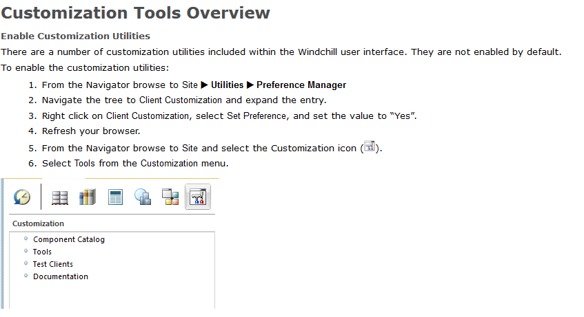

If you want to know something about, you have to enable Customization Icon in the navigator bar1+-+Customization+Tools.PNG

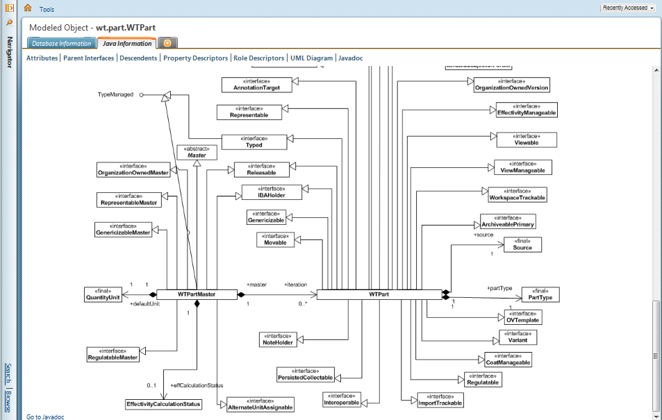

Then pick Tools and select Modeled Objects.
Now in the Column Descriptors you can do a Search in table with the type, for example Wtpart.
Once you have found your type, select Information, Java Information tab and finally UML Diagram.
Marco

Is there a way to control who has access to the Customization Utility?
-Cam
MarcoTosin
Feb 6, 2015 1:55 PM UTC
Cameron,
as you can see in the first image attached to my previous comment, you have to be site admin to enable the preference.
Other roles cannot.
