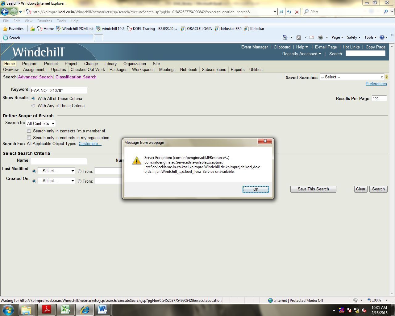

Everything was working fine, until today morning I walked into office and started to search for a document in WIndchill 9.1 PDMLink and received the com.infoengine.au.serviceunavailableexception.
Pl see attached snapshot....
Quick help is appreciated, being the administrator, i am stumped by this error with no solution in sight.
February 16, 2015
In my experience the error generally indicates that the MethodServer is not running. You could try restarting the system and check.
