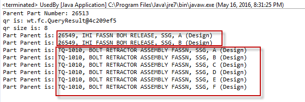

Here is what I get:

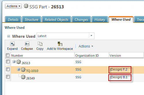

Here is in Windchill what I have:
How do I get the latest part version?

May 17, 2016 7:26 AM UTC
Antonio,
Use below code and let me know if works
Shreyas

May 17, 2016 3:33 PM UTC
Shreyas,
Thank you so much!!
Very smart way to use the allIterationsOf() and to actually create an Hasmap with <Number, WTPartMaster> (not so useful using the WTPart like I did)!
I am just learning coding, but you help me understand a little better that the solution is easy and there, I just need to stop it for moment, step away from coding and look at the problem from another prospective .
