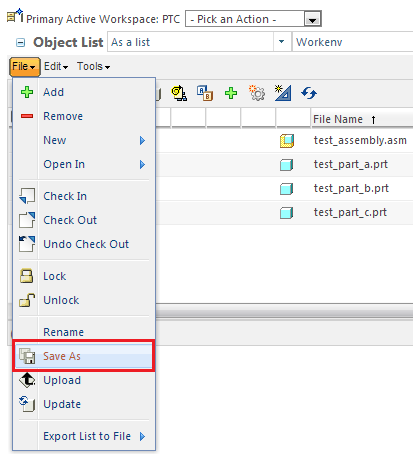

Going from intralink to windchill want to know where Export to "Workspace" is in Windchill
We just started using Windchill with minimal training , was wondering where export to "Workspace" is in Windchill?

Oct 7, 2015 8:33 PM UTC
Save-As.

Oct 7, 2015 7:02 PM UTC
in your workspace view.. there is a "Tools" pull down.  it is located in there.
rcote1-VisitorAuthor
Oct 7, 2015 7:08 PM UTC
I want to go from one workspace to another I dont this will achieve that but correct me if im wrong.
2-Explorer
Oct 7, 2015 7:14 PM UTC
what you can try..
hit the checkbox, to select all items you want to export.  if you want the whole workspace, just the top checkbox, to select all.
the next window that pops up, you can browse to a target directory, browse to say.. a folder you created on the desktop. or somewhere.. then  click OK.  it will export the items to the folder
then, in your target workspace, go to tools, import, and browse to that folder.  and they should be there.  highlight all, and hit ok.
2-Explorer
Oct 7, 2015 7:16 PM UTC
it will bring the items into the workspace as new items.  if they exist in commonspace already, you can select all, select update icon, and update. then do a synchronise.  this will make sure the items have the correct revision, and correct folder location for checking in.
