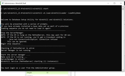

Hi Experts,
I am just wondering is there any data inside the GOLF_CART product?
I have installed the WC 13 successfully with demo and all other data load conditions are checked during the installation. Installation was successful but I haven't check GOLF_CART product.
Now I can see it doesn't show up any demo data?
No CAD documents and No WC parts etc   Can someone confirm it the GOLF_CART is having any data when we load a demo Data during the installation.
or If I have missed anything or any sort of issue which can cause this?
It will be great help if get any suggestions on this as we are bit stuck here ...
Feel free to leave comment if I have missed anything...
Thanks in Advance.

The golf cart should have some data :
you can try to reload the demo data manually , maybe something went wrong during installation .
Buiꓘa
May 30, 2025 10:08 AM UTC

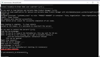

 I did tried the manual upload it says its complete but doesn't show up in the Windchill. check below images...any other suggestion so far, I recall there was no error...and sadly other Product like "Drive Systems" and other shows the data only issue with GOLF_CART...

Do you see any errors in MS either during load or when accessing the loaded product ?
is this specific to Golf_Cart do you see data for Drive System ?

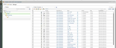

I have always thought the Golf_Cart demo was product structure only, no CAD files.
avillanueva
23-Emerald II
May 30, 2025 1:48 PM UTC
I was going to say that too. There were representations loaded but you cannot load CAD from ImportfromFile methods.
Fadel
23-Emerald II
May 30, 2025 1:50 PM UTC
The issue looks more permission issue , even the 2 OOTB folders Design and manufacturing are missing on the screenshot

Jun 17, 2025 10:07 AM UTC
Hi Fedel,
I am still in discussion with PTC but no solution on this yet. We did try below solution but no luck
1.Manually data upload
2.Copying the Golf kart folder from other server where it looks fine and rerunning the loading demo data. Physical files are present inside the gold kart folder on system but unfortunately, it's not visible or loaded to the WC. No success yet.
3. We tired clearing the Chache but no luck so far
PTC support team is working on it and solution is still awaiting.
