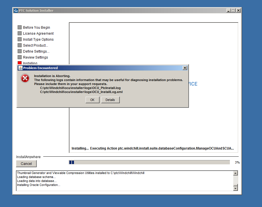

Got an error while installing Windchill 11 on Windows 7.
Hi Guys,
I have got an error while installing Windchill 11 on Windows 7 OS. I have attached the screen shots of the error i got after clicking 'Install' button again and again. Kindly help me to get resolved it so that i can install the software easily on my PC.
Kindly review my attached screen shots and log files for an error.

Set SQLNET.AUTHENTICATION_SERVICES to "NONE" in the sqlnet.ora file?
By default the property SQLNET.AUTHENTICATION_SERVICES is set to "NTS".

Here i am using Oracle as database and i have set already as per the requirement into tnsnames.ora file.
I have started it's required Listener and and it maintains entry into tnsnames.ora file.
but since, got the error shown above.

Try to set SQLNET.AUTHENTICATION_SERVICES = (NONE) in the sqlnet.ora client file )
