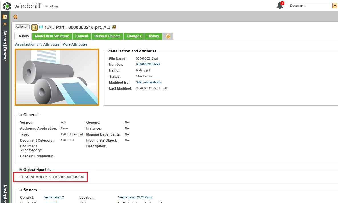

I saw your post and thought this should be a good one to figure out.
In short, rather than have the display be in scientific notation for a specific FloatingPoint attribuite (not all FloatingPoint attributes) you want the entire number written out.
For example, rather than 1E17 you want to see 100,000,000,000,000,000
If I understand you correctly, I have figured out how to do this.
See image below.
David

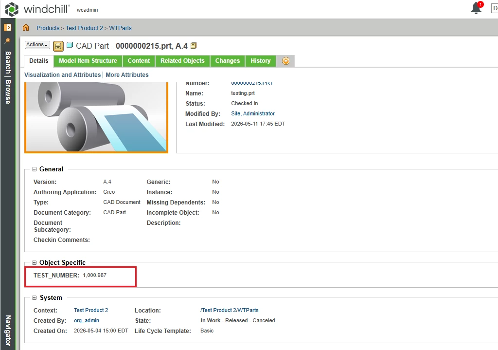

​@LewisLawrence
Not a problem re: trailing zeros. How many do you want? I’m thinking 1 or maybe none.
18-Opal
May 11, 2026 10:28 PM UTC
I have this working now such that all trailing zeros are removed from decimal values.
Code is bombproof. 😉
