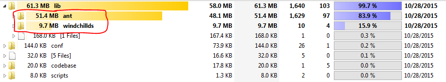

Has anyone try the new Rehosting Utility 3.0?
Has anyone try the new Rehosting Utility 3.0 yet?
The download page for the Rehosting Utility 2.0 is 27 MB in size, while Rehosting Utility 3.0 contains only 163 KB in size.
Want to make sure before downloading.  We are just upgrading to 10.2 M030.

I've downloaded it but haven't tried it yet.  3.0 doesn't include the ANT or Windchill DS stuff.  Not sure why...

I downloaded, installed, used a few times for the simplest situation - two workstations with Windchill and Oracle installed w/minimal data.  Worked ok.  Now to add scripts, etc. etc. Lots of documentation and generally good, but still I find it extremely difficult to use PTC documentation for Windchill admin's in general.  As almost always, I created a spreadsheet of all the modules and related properties - helps a lot.
