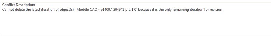

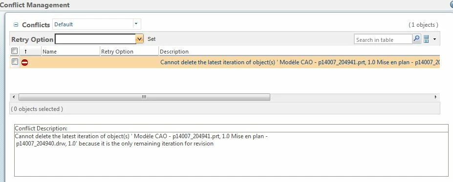

see in the sreenshots attached, I want to delete the files P14007_...
For that, I have to delete the last version of the generic 501109.
But the system doesn't accept! see the message attached...

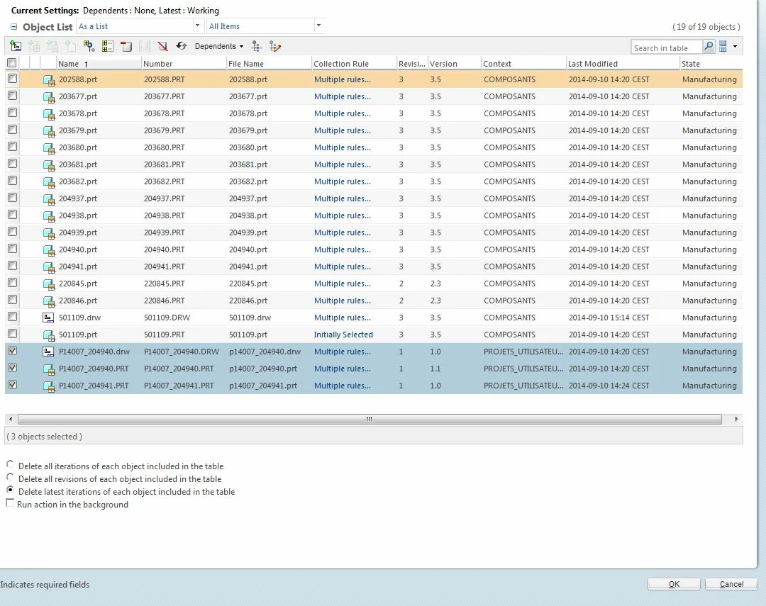

Oct 7, 2014 7:10 AM UTC
Delete that part also whose number is showing in the error.

Oct 7, 2014 6:12 AM UTC
As showing in the image the version of the selected drw is 1.0. That menas it didn't iterate after creation.
So, In order to delete the latest version you have to delete that drw itself.

I 've deleted the drawing,
but it's this message:

lzanettin1-VisitorAuthor
Oct 7, 2014 7:20 AM UTC
iT works!
