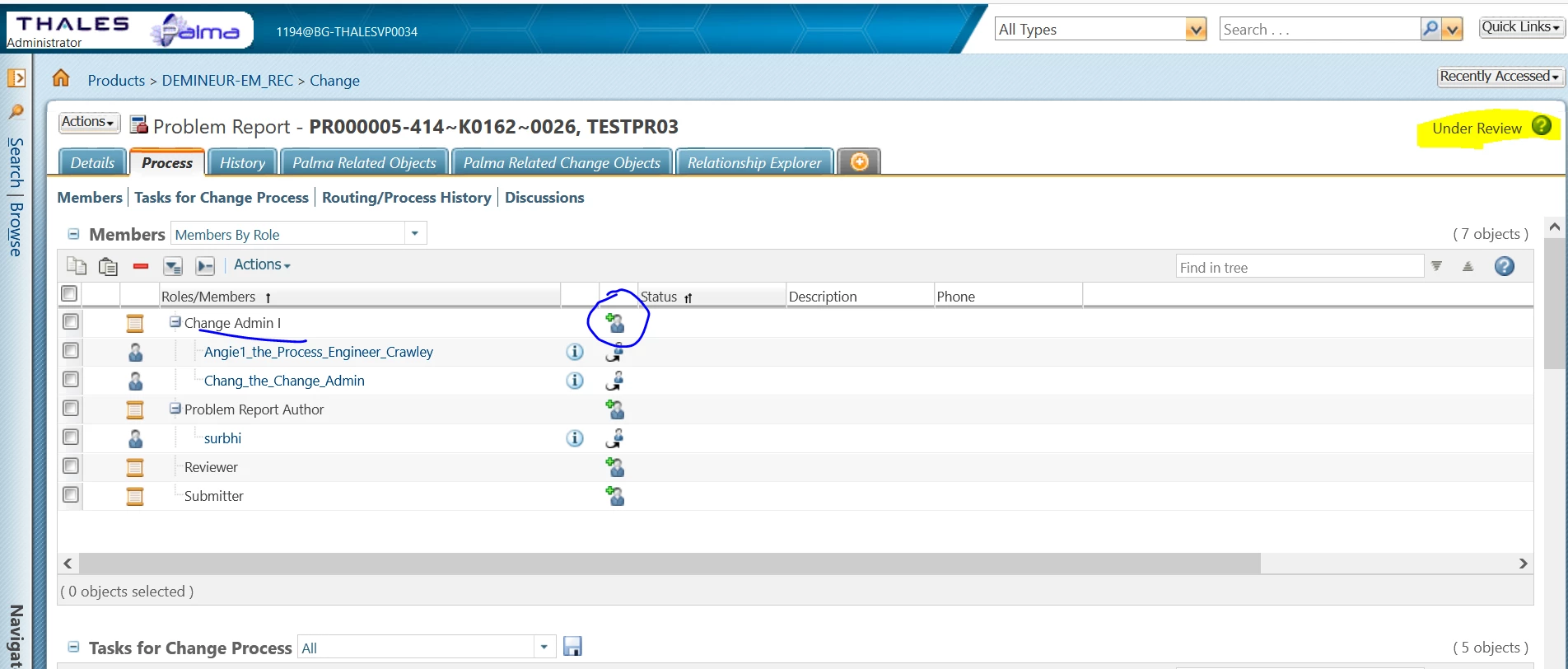

Hide Add participant action for CA1 role if user is part of PRA role and PR is in Open state.
I am using Windchill PDMLink Release 10.2 and Datecode with CPS M030-CPS22
This is simple business requirement, can be tested or implemented on any latest Windchill version.
Step 1: user is part of Problem Report Author(PRA) for PR object
Step2 : If PR state is Open, then only allow PRA user to show add particpant icon for CA1 role in Members table.
Step3: If other then Open state, disable/hide the add participant for CA1 role.
For this i have written a validator is current user is part of PRA role, if so, then check for state of the object.
But stuck at a point, how can i check and hide the add participant action for CA1 role.
Is it possible thru Validator? or DataUtility?

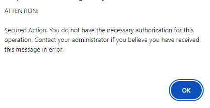

Hi @SY_10256354
I would solve your issue by just configuration an advanced lifecycle state and permissions by LC.
Set deny Change Permissions and then grant access on it in the lifecycle
The ACL Change Permission is responsible to allow user change Members on the object
The icon does not disappear but user can not change the members
PetrH
