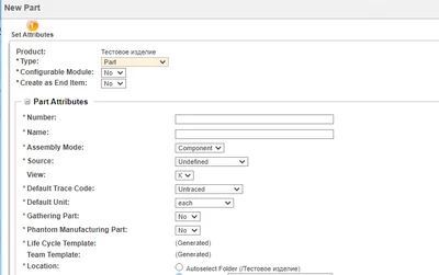

Hello everyone, can you please tell me how can I add a prefix to an autogenerated number?
How to get this number: ABC.000_018_5268?

   ,thank you very much for the quick response. I added your code, but now the number is no generated automatically

Nov 23, 2020 2:48 PM UTC
Sorry, that was for a promotion request, not a new part. Here is the code for a new part.
 set the number to a generated number
- <AttrValue id="number" algorithm="com.ptc.windchill.enterprise.revisionControlled.server.impl.NumberGenerator">
 - <Value algorithm="wt.rule.algorithm.BooleanBranch">
  <Arg><YOUR PREFIX HERE></Arg>
<Arg>{GEN:wt.enterprise.SequenceGenerator:WTPARTID_seq:10:0}</Arg>
  </AttrValue>
Try that instead.
