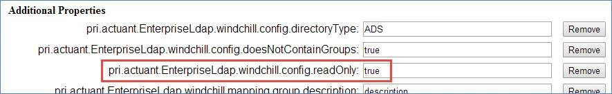

Aug 13, 2014 6:27 PM UTC
Lewis,
How do you update the username if you're connected to AD? Do you set the property in the adapter as <adapter>.windchill.config.readOnly=false to make Windchill think you can update the username in the AD?
Ben

Aug 14, 2014 10:06 AM UTC
We are not truly integrated with AD, we actually manage the user accounts in Windchill but connect to AD to validate the password. By updating the username in Windchill it no longer matches AD and the user cannot authenticate.
