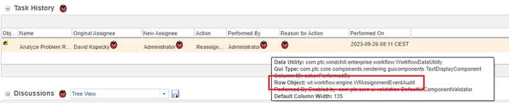

How can Action Performed On property from Work Item be added to a report template?
I am trying to create a report template that includes the "Performed On" value found under the Task History section. I was able to find actionPerformedOn under Property Report when looking up wt.workflow.work.WorkItem but cannot find actionPerformedOn when on the "Select or Constrain" tab when created a Report Template.
Any advise it appreciated. TIA

Hi @mariaSutton
This page can help you Windchill Reporting Resource (@Marco_Tosin was faster 😄)
and here is many reports created by other users
Resource for reporting
additionally I use jcaDebug=1 for getting detail information about object in tables.
here is an article how to use it How to use "jcaDebug"
here is example how I found the table
PetrH

I am not sure if WfVotingEventAudit is the correct table. The property I am trying to capture can be found when looking at the Task page in Windchill. On the Task page there is a table called Task History; in this table there is a column named Performed On.

Hi @mariaSutton
Can you show it ? just take a screenshot what you are looking for.
