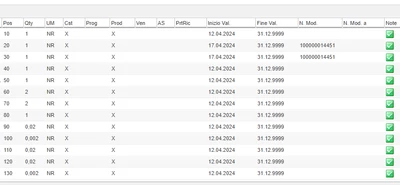

MarcoTosin
May 14, 2024 3:14 PM UTC
Hi Antonio,
our consultants have developed for us something like what you need.
Basically, when you go to the information page of a WTPart in Windchill, some BAPIs from SAP are called up to get several pieces of information, about the material master, the bill of materials, and the related cycle, if it exists.
In the first case (material master), the display BAPI is called up and, if it has already been created and is aligned with the data sent from Windchill, the green icon with the big teeth that can be seen to the right in the attached image appears
The icon on the left, with the traffic light, on the other hand, is for the status of sending the bill.
Clicking on the traffic light performs a real-time comparison between the Windchill BOM and the SAP BOM.
In the second image is an example of the compared data, purged of sensitive data such as name and number
