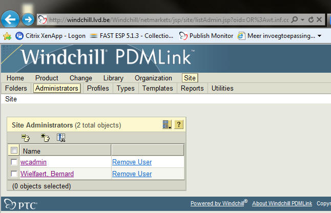

How can I get the email address of the administrator in Windchill ?
I have a java method that will send an email when dxf creation failes but how I can get the email address of the administrator configurated at Windchill ?
I hardcoded the email address now but it should be better if the java class does not need adaption when the administrator should ever change.

Bernard, Once you have the admin as a WTPrincipal object, you can use below lines to fetch emailAddress dynamically:
String adminEmailId = null;
if(WTUser.class.isAssignableFrom(admin.getClass())){
WTUser adminUser = (WTUser)admin;
adminEmailId = adminUser.getEMail();
-Prabhash

Dec 12, 2014 8:29 AM UTC
The wt.mail.from is the senders email address (WindchillAlerts@lvd.be), I was looking for the administrator that is configurated via Site/Administrators, see picture a litle further.

Dec 12, 2014 7:21 AM UTC
I like to mail the Site administrator like in next picture. We are still running 9.1Snap1.jpg

Hello Bernard,
I guess you can use SessionHelper.manager.getAdministrator() to fetch the wcadmin user.
Let me know if you need any clarification.
