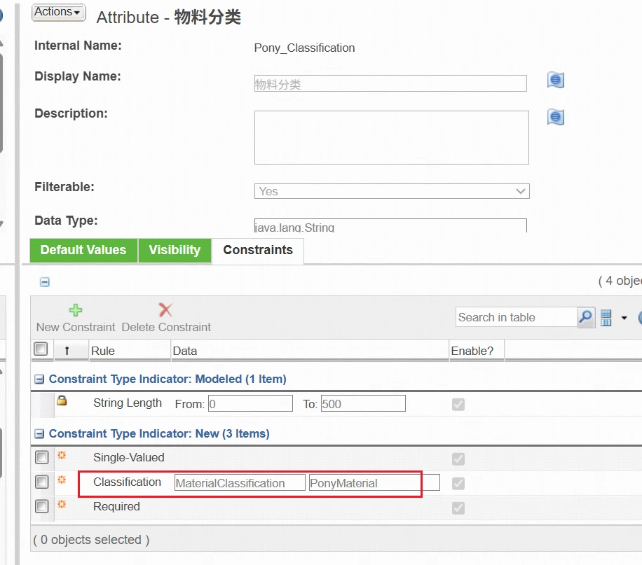

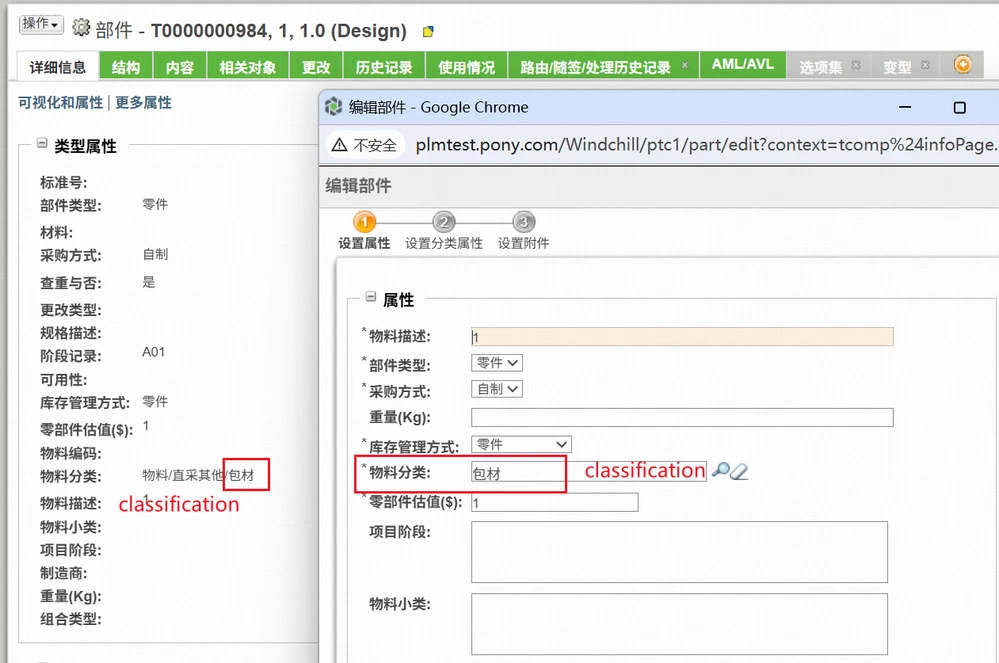

How can the parts classification attribute be set to display only the smallest category?
I am using Windchill PDMLink Release 12.1 and Datecode with CPS 12.1.1.0
How can the parts classification attribute be set to display only the smallest category instead of the format of "major category/middle category/small category"?

Are the middle classification instantiable? Try toggling them to not instantiable and it should skip over them.
Jun 4, 2025 2:10 AM UTC
Only the smallest classification is instantiable.
