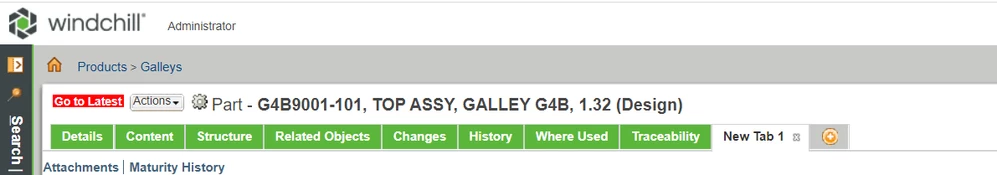

How do I expose the WT_PART "Content" tab?
I am using Windchill PDMLink Release 11.0 and Datecode with CPS M030-CPS16

    Feb 15, 2022 8:05 PM UTC
    This is my top menu for a WTpart. It is on by default.
    Has your sys admin turned it off or set up profiles that hide certain menu functions?

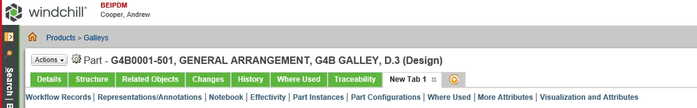

    Feb 15, 2022 8:32 PM UTC
    This is the old top menu
    This is the new system top menu
    It appears that the OTB configuration does not display the "Content" tab
    Feb 15, 2022 11:58 PM UTC
    I notice that one user is the administrator and the other is a named user. Is the named user part of the administrator's group or have admin rights? It looks like it may be a profile applied to the users but not the administrator.
    I just checked my Windchill 11.0 M030 system and a normal user is showing the same set of tabs that I pasted in here before.
