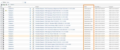

How do I find all the tasks?
In the context of "Recent Products" there is a tab "Tasks". I can view all the tasks in one context.
Please tell me how to view all tasks in several or all contexts at once through search or reports?

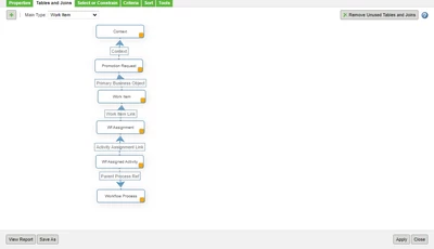

I couldn't display the "State" column. Please tell me how I can display it?
joe_morton
Apr 11, 2022 1:16 PM UTC
It looks like you want to report on Promotion Requests tasks. To show the state of the promotion request, you can join the "Work Item" to "Promotion Request", then add the State property from the Promotion Request. In my reporting, I like to see Context as well, and show "Context Name".  Example:
