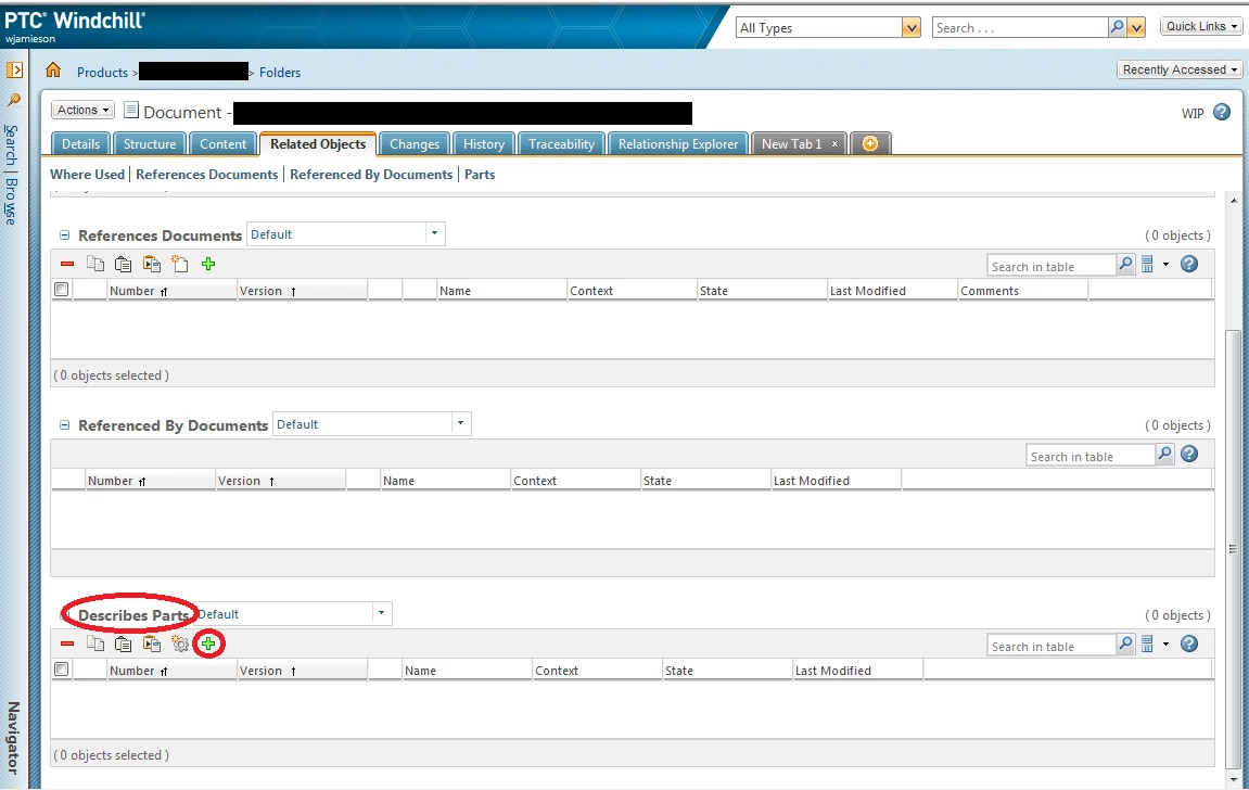

How do I relate a CAD .prt or .asm file to a document stored in Windchill?
I am currently uploading numerical calculation documents for certain products to the Windchill system. I would like to relate the CAD .prt and .asm files of the products used in the calculations to the actual calculation document. How do I do this? I have tried adding a part to the "Describes Parts" section of the "Related Objects" tab (shown in the attached picture,) but Creo only allows me to relate the document to WTPART files. All input is appreciated!

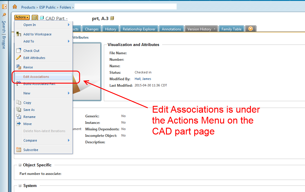

May 8, 2015 1:41 PM UTC
Perhaps you are looking for the Edit Associations tool that is found on the PRT or ASM actions menu?
wjamieson1-VisitorAuthor
May 8, 2015 8:33 PM UTC
I'm not sure which menu you are referring to. Can you tell me how to navigate there? Thanks!
