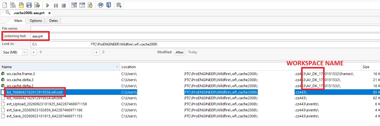

I created a new drawing a part in one of my workspaces, but between switching to other projects I forgot which workspace I created it in.  How do I search all my workspaces for this part and locate which one it is located in.  Is there a way to search your workspaces?

HelesicPetr
Sep 23, 2026 8:32 AM UTC
Hi ​@cschmid_190867
Actually if you do not upload the CAD Model you are not able to find it by any users friendly way.
If the CAD Model is uploaded, then Windchill system knows about this object and you can use a simple search
If you need to know where the not uploaded models are located in the local cache workspace then you have to go to the cache folder
Then you have to use search tool and search the file name inside the files.
then you can locate where the model is stored.
