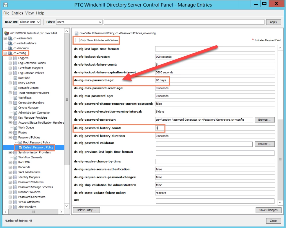

Hi @YZ_10818805 ,
What do you mean is that the validity period is 3 months, and after that, you cannot log in with a password.
Refer to the following figure and set the ds cfg max password age to 90, in days
