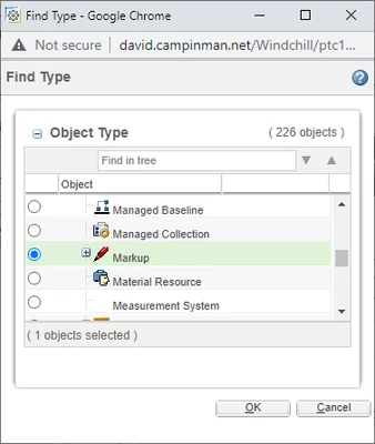

I want certain users to be able to see the default representation of an object in Windchill but not a saved annotation set with markup comments.  What do I need to use in the ACL to achieve this?  I'm on Windchill 11.1.

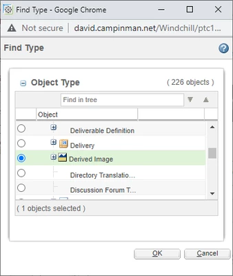

Policies on Representation can be set using "Derived Image" however this will affect ALL Reps not just the default Rep.  There is no OOTB way to limit it to just the default Rep.
Markups can be controlled using "Markup"
