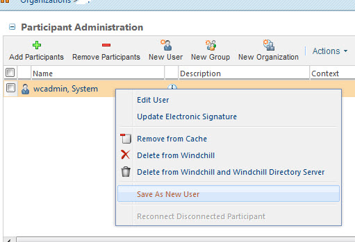

Might be 10.1 m020 and onward.
Save As New User Action Available From Participant Administration Utility
http://support.ptc.com/cs/help/windchill_hc/wc102_hc/WCUpgradeCFTR_SaveAsNewUser.html
8 replies
Jan 30, 2015 5:36 PM UTC
From Participant Administration:
Add Participants
- Search and Add User to Participant List
Then right-click and Save As New User

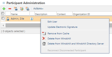

Marvin,
Sounds simple, but it is not an option for me. I am missing something.
Jan 30, 2015 6:26 PM UTC
The Save As to create a new user has been removed from 10.0+.
All users need to be added through the Add New User Icon or Action.
Jan 30, 2015 6:44 PM UTC
It is there for me in 10.1 m040.
cswaner10-MarbleAuthor
Jan 30, 2015 6:47 PM UTC
We are using WC 10.1 m010... Is there some sort of property or preference to unlock it?
Jan 30, 2015 6:50 PM UTC
I do not know off hand, but who are you logged in as? I'm logged in as orgadmin.
Jan 30, 2015 8:08 PM UTC
Loged in as Wcadmin on 10.0m040 and it is not there.
