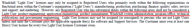

There is no difference in Windchill.  The difference is legal and depends on who is using Windchill and how they are using it.  I suggest you read through these:
https://support.ptc.com/appserver/cs/view/solution.jsp?n=CS45002
heavy/light windchill licenses

Light users would those who access WIndchill only from a web browser.
Heavy users are connected to Creo.
You do need to read the legal definitions that Tom linked.

Unfortunately it's not quite that simple.  Users in certain departments and roles, even if only accessing Windchill from a browser, are still considered "Heavy" users.  For example, "Managers" can never be "Light Users", even if they don't do any "Heavy" stuff.
The workaround to this of course is to give your managers "View/Print Only Licenses".  (Assuming they don't actually need to change anything in the system.)
