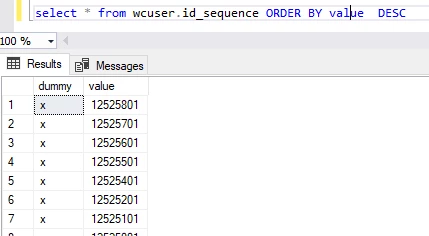

HelesicPetr
Dec 20, 2022 8:28 AM UTC
Hi @ptc-1011665
The ida2A2 value for EPMDocument is generated by id_sequence in database. In this table are the numbers that are used for ida2A2.
The numbers are cached so in my case I can find only each next one hundred value.
I'm not sure if this can help you to restore the EPM rows.
last EPMDocument row
The information I found in follwoing article : CS367634

Dec 20, 2022 3:07 PM UTC
The article talks about wtpart.  Does the same holds good for epmdocument as well??
HelesicPetr
Dec 20, 2022 3:12 PM UTC
It is used for everythink
