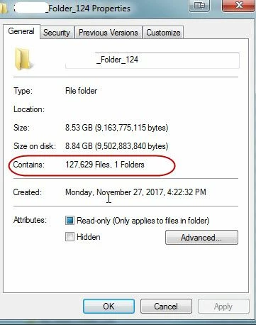

We also capped off our file vaults at 50,000 files, but for some strange reason it likes to double that amount and I usually see 90-100k files there.
Mar 21, 2018 8:19 PM UTC
The roll over rules set for file vaults states that +/- 10% of your set limit maybe when the next vault is activated and the current vault is set to read-only. With the 50K limit, I have never seen my vaults get over 53K before they roll over.
What OS are your vaults on? I wonder if that may have something to do with it.
Mar 22, 2018 11:53 AM UTC
First I started with Server 2008 back in 2011 and am now on Server 2012R2 Standard.
