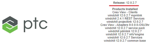

What version of Windchill?
What operation are you performing when you get this error?
Aug 7, 2023 6:33 PM UTC
Thanks for the response.
Not sure of the version of Windchill (where do I find this?).
The error occurred when trying to upload or check-in an assembly.  I had incorporated new sub-assemblies and also added some parts to better reflect the actual unit in place on the production floor.  Surprised that Windchill/CREO does not provide an better description of what dependencies are in conflict. Anyway to find this out?  Greatly appreciate any help on this. Also, if you can tell me how to find the version of Windchill I am using, I will get that info.
HelesicPetr
Aug 8, 2023 6:07 AM UTC
Hello @SM_10398034
You need to contact system administrator to check what error is in the log file on the server. From the log you can find what is wrong.
version of the Windchill can be find in a Quick links
Petr
