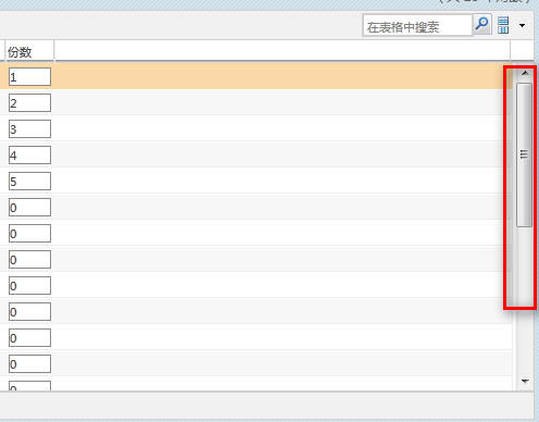

how to abrogate mvcTable' Scrollbar
hi all,
     how to abrogate mvcTable' Scroll bar , for example:
table show all datas,    don't    drag Scrollbar.
Dec 8, 2015 2:48 PM UTC
Hi Chao,
Is this a custom table? You can specify the table height to show certain number of objects without table scroll bar while calling the builder as shown below:
<mvc:tableContainer compId="tableID" height="1000"/>
Also, I believe you can set the height using JavaScript after the table is rendered.
var tableCmp = Ext.getCmp(tableId);
          if(tableCmp.getHeight()<200) {
            tableCmp.setHeight(500);
