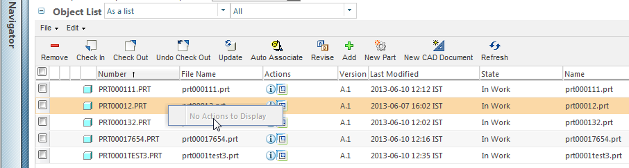

How to add an action on right click in the Object List table of workspace?
The Object List table in Workspace of any product has no actions on right click of the objects. i need to add one.
I have done that for other tables by using "menufor" in the actionmodel and then calling this actionmodel as a column in the TableBuilder class. And it worked.
ColumnConfig testcolumn = factory.newColumnConfig(DescriptorConstants.ColumnIdentifiers.NM_ACTIONS, true); ((JcaColumnConfig)testcolumn).setDescriptorProperty(DescriptorConstants.ActionProperties.ACTION_MODEL,"testactionmodel"); table.addComponent(testcolumn);
But i am not able to find the TableBuilder for the Object List table. Anybody has had any experience here.
Setting jcaDebug=true, also doesnt reveal anything. Normally, it would have directly given me the TableBuilder name.
