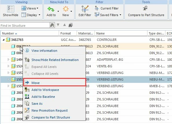

I am unable to add custom actions in Product Structure Explorer (Windchill 10.2). I do not see any error in Method Server as well.

What kind of action are you trying to add and to where in the PSE? Individual row action? Menu bar?
rl-21-VisitorAuthor
Nov 24, 2014 5:54 AM UTC
Thanks for your comment.
I am tring to add an action to the context menu (the menu that appears after right click of part in PSE) like as shown in the image below.
Is this possible? if not what are the other possible ways of performing an customization in PSE to have our own custom action?

The articales you have shared talks about Report Customization in PSB, If i understand from your comments, You want me to make use this LaunchURLAction class to call my own custom class in the JSP?
Please let me know if my understanding is correct.
Thanks once again.
Dec 2, 2014 7:03 AM UTC
It depends on your action, what is the purpose of your action...
In my case, i needed to add Move action so I build custom URL and redirected with javascript:
My jsp, which I'm calling from RMB menu looks like this:
<%@ include file="/netmarkets/jsp/util/begin.jspf" %>
String prURL = ext.psb.ContainerMoveAction.URL(commandBean);
<script>
window.location.href = '<%=prURL%>';
</script>
<%@ include file="/netmarkets/jsp/util/end.jspf" %>
