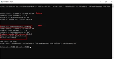

18-Opal
Jan 5, 2025 4:47 PM UTC
@HelesicPetr , as usual you are correct.
Using pdfbox I added properties to a pdf file created by publishing a Creo drawing.
The new properties are definitely in the pdf.
The code accepts argument input pdf and writes its properties to the shell.
Then adds the new properties and saves the pdf as a new pdf.
Then writes the new pdf's properties to the shell.

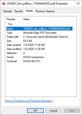

However, @Vedamurthy   if I go to the pdf and select properties only the OOTB properties are displayed.
I'm guessing which properties to display are hardcoded.
