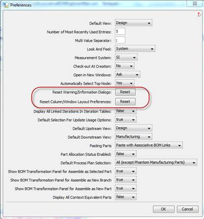

5. Open MPSE
6. Go to file -> Preferences
7. Reset below highlighted entries:
8. Stop Windchill Method Server
9. Clear Tomcat & Info*Engine cache
10. Restart Windchill Method Server

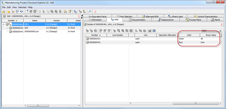

11. Now you will see two newly added IBA will get displayed in MPSE with correct values.
