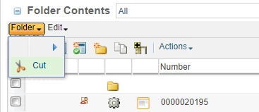

Example how it looks like (i didn't define the name of submenu so it is without names :D)
I extended the FolderTableBuilder and added the submenu definition
@Override
public ComponentConfig buildComponentConfig(ComponentParams componentParams) throws WTException
ComponentConfig compConfif = super.buildComponentConfig(componentParams);
ComponentConfigFactory factory = this.getComponentConfigFactory();
((JcaTableConfig)compConfif).setMenubarName("folders table menubar");
return compConfif;

A label is shown with own resourceBundle definition
