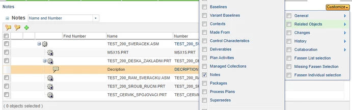

Have you seen a Note functionality for the BOM?
Check it.
Viewing Structural Notes for a BOM

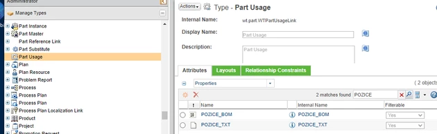

Or you can add a BOM (Usage) attribute that could be shown in the structure and related to the assembly.
Same as an Quantity.
Managing Reusable Attributes

Apr 22, 2024 12:45 PM UTC
Petr,
I looked into this.  We needed to enable it to get it to work.  It will work but it seems to be limited in the number of characters that can be entered.  The interface to enter text is also somewhat restrictive.
I'll work with it more and see where it goes.
