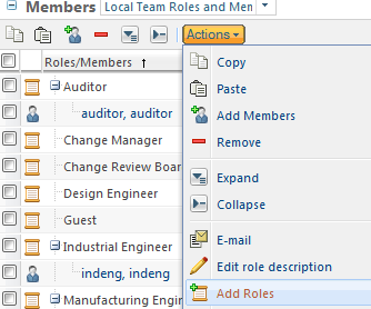

Unless I'm misunderstanding what you're attempting, I do it through Browse (next to the search tab) > [Recent] Product > expand the Context node > Team page > Actions menu > Add Roles.
