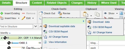

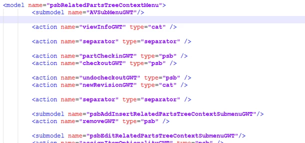

HelesicPetr
Apr 21, 2022 11:32 AM UTC
Hello @Pushpak_Old
It's easy. Just edit a custom-actionModels.xml (codebase/config/actions) and add a submenu definition in it.
In my case I use name of submodel AVSubMenuGWT
then use this definition in a menu where you need.
for structure menu the name has to end with GWT
menu for psb (wtp structure)
Restart Windchill and Submenu will be there (without display name)
I guess you would need to add a Display name of the submenu.

then you need to compile this resource bundle file
in windchill shell
ant -f bin/tools.xml class -Dclass.includes=cz/aveng/AVCustomMenu/psbCustomActionsRB.java
class file should be created and located in ..\codebase\cz\aveng\AVCustomMenu\psbCustomActionsRB.class
in the end the resource bundle should be added in the custom-actionModels.xml see the first picture.
After restart windchill the submenu should have a display name
Hope this can help.

Apr 21, 2022 11:44 AM UTC
Hi @HelesicPetr ,
Thanks for the quick response !!!!
Now I am able to add the new action under Part structure but the only problem I am getting is like its getting hide everytime. Do I need to set any other property to get it visible except validator .
HelesicPetr
Apr 21, 2022 11:49 AM UTC
Hello @Pushpak_Old
Are you talking about your actions in a submenu or the submenu?
All action names in the structure have to end with GWT (internal names in customaction.xml).
It the WGT is not there, then it is hidden all the time.
in my example you can see that my custom actions always end with GWT
