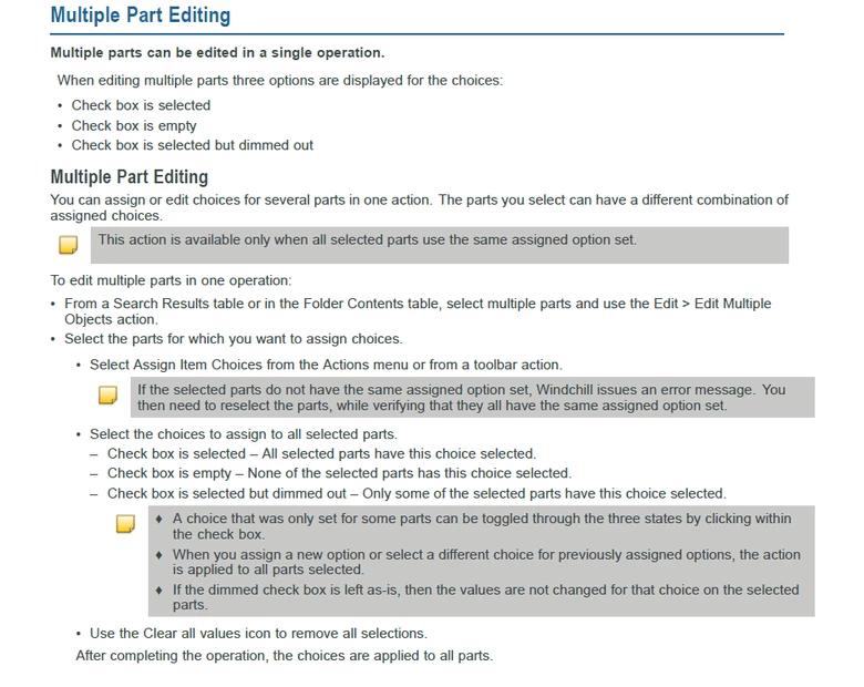

There is written:
1. select multiple parts and use the Edit >Edit Multiple Objects action;
2. select the parts for which you want to assign choices;
3. select Assign Item Choices from the Actions menu or from o toolbar action.
I'm stuck on the second point

    It is not possible by User interface
    You need to use loadfromfile utility from Windchill Shell
    the help describes how to do so Using Load Files to Update Options and Choices
    if you need more how to use load from file utility
    check this help
    Using the LoadFromFile Utility

    Gucio16-PearlAuthor
    Oct 11, 2023 1:36 PM UTC
    PetrH,
    it used to be written in ptc university's documentation

    Hi @Gucio
    Do all parts use one option set?
