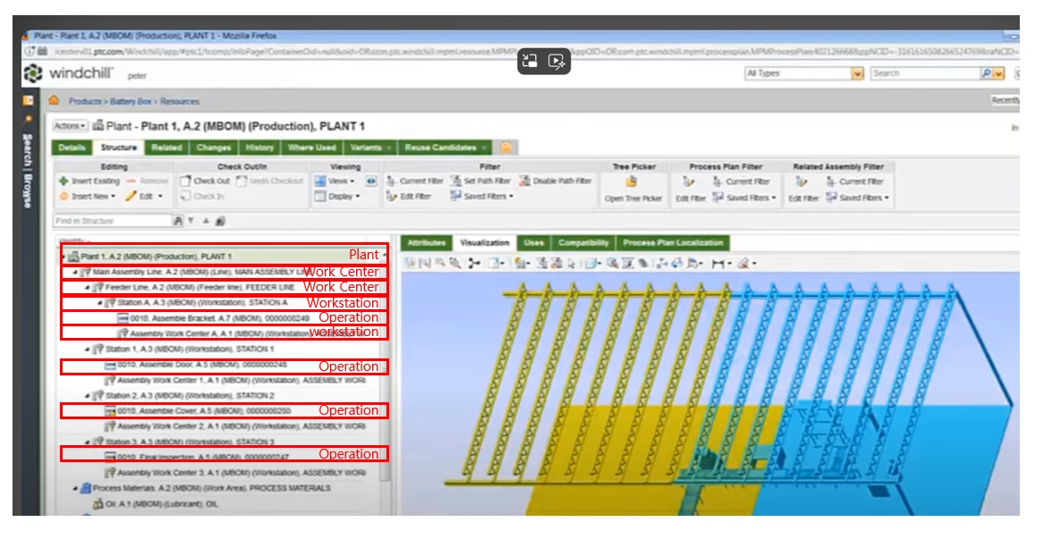

Use Case: Dear, I just want to build structure including operation on Plant structure tree such as the attached image. How should I do to make this?
Description:
Dear,
You can see the plant structure in left and also information was built with "0010" operation.

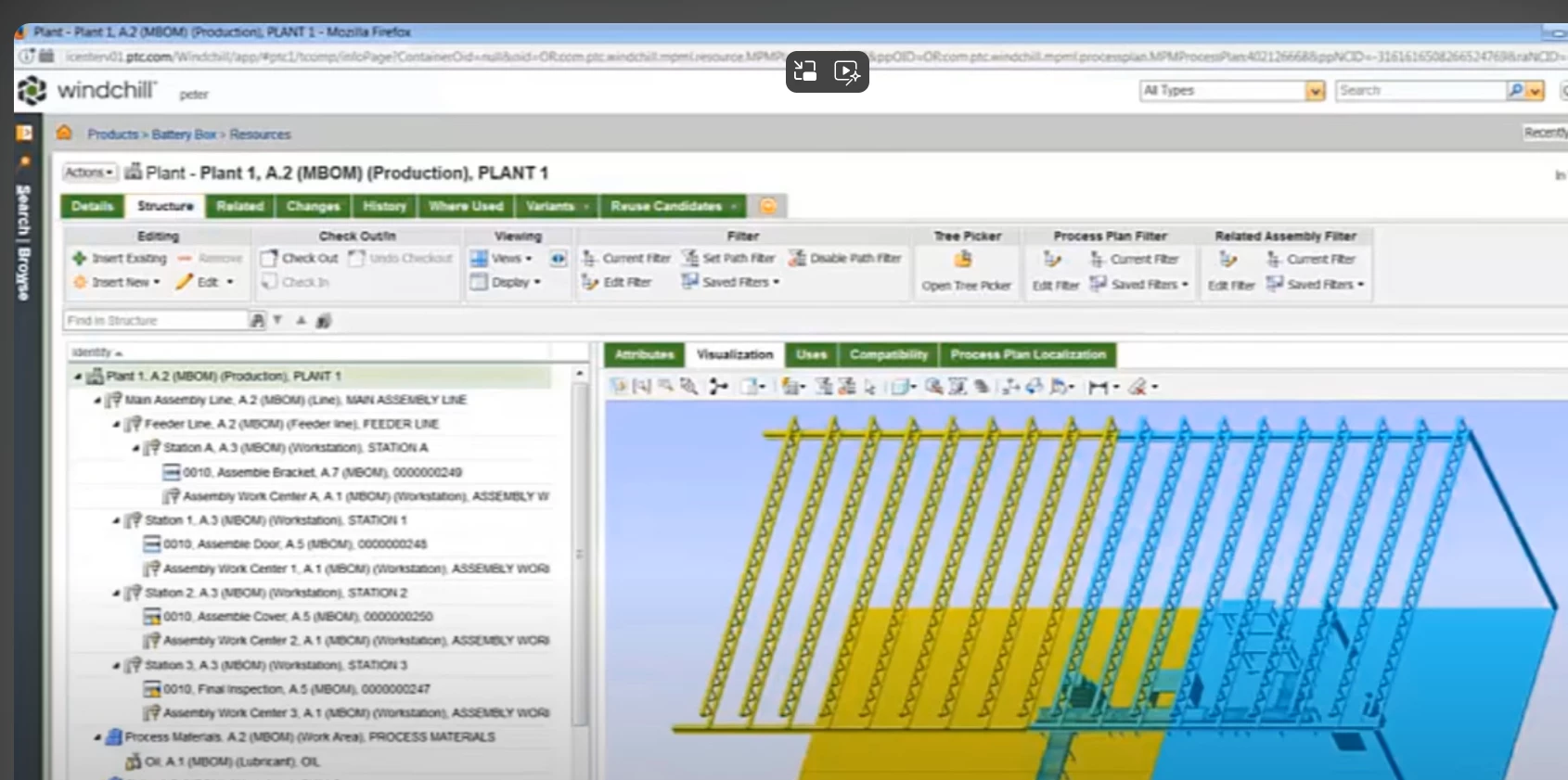

My additional critical point is how to make structure in 2nd image.
My main question is how to add " 0010, SUB1_Name~", "0040, Name_0010", " 0050, Name~" such as the below.
I cannot add them into the below Work Center or Workstation?
Test Plant
 - 10, Linka
   - 10, KIT Pracovisite
      - Pracoviste
         0010, SUB1_Name
         0040, Name_0010,
         0050, Name
 - 20, Pracoviste
    - 0010, TOP_Name
    - 0020, Name_0020

Did you review attached image?  You can see the operation “0010 ~~”. I believe this is operation from process plan.
You can take a look at this feature in the below, especially 11:50 ~. 12:05.
https://youtu.be/lzdyIO-kjVA?si=nJZdiqzZNACvLR2h
I’d like to know how it is possible.
Thx

I did try to create the plant structure and I could make the below
Plant - Work Center - Work Center - Equipment/Jig
                                                                - Part
But I couldn't make such as the below
Plant - Work Center - Work Station - Operation
                                                                - Workstation
I want to configure structure the attachment but I couldn't add the Operation. 0010, Assemble Bracket (might include resource & part).
In the movie I can take a look at whole assemble sequence on Visualization by Playback Actions.
But I couldn't configure structure similar with movie and I couldn't play operation such as movie 11:50 ~ 12:05 on Related Plant.
Ie, in the movie I can see Process Plan Structure and open "Open in related Plant" .
And then I can see the assemble sequence with Playback Actions icon. But I cannot do this. This is exactly my question.
Thanks a lot.
