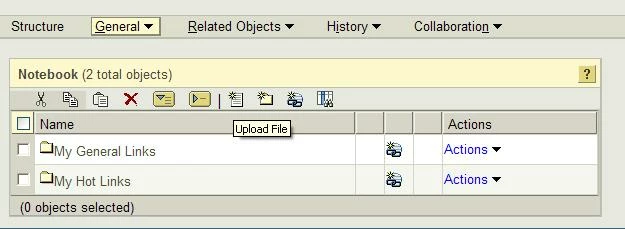

David,
We use the Notebook function. When you are on your part or assembly page, Click General >> Notebook. There will be an option to Upload File or Create a Link. You can also create a folder for the file(s), if you like. Once you upload the file, whenever you go into the part, you will be able to open Notebook and see the file. I have attached a screen capture of the Notebook area.
We have had a glitch with rights, that if the file has been promoted, the general user cannot add a file to the Notebook section, so if you do not have the icon to upload or link, you might want to talk to your administrator. If nothing else, they can do the link or upload the file.
Hope this helps...Brian
