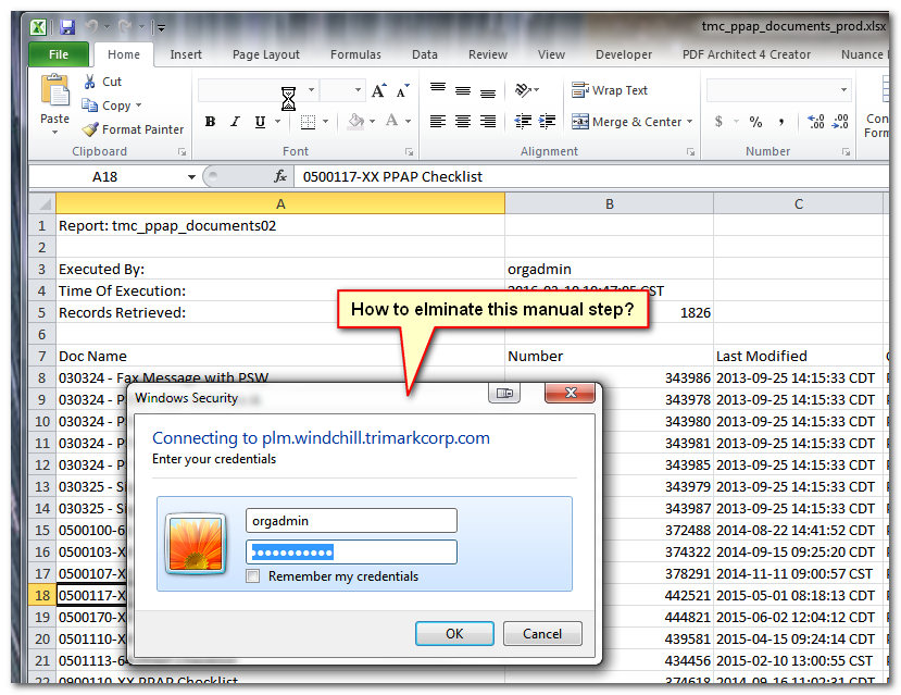

Hi Y'all,
I have an Excel spreadsheet that calls a Windchill report and I want to have it automatically refresh everytime it is opened with no user interaction.   Anyone do this before?
-marc

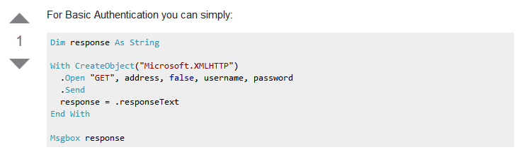

After much searching and trial and error I ran across the solution here: http://stackoverflow.com/questions/22149169/how-to-pass-authentication-credentials-in-vba
Place the following code in the ThisWorkbook section in the VBAProject in Excel.  Change to point to your server and also use a valid username and password.
Private Sub Workbook_Open()
With CreateObject("Microsoft.XMLHTTP")
  .Open "GET", "https://your.windchill.server.com/Windchill/app", False, "username", "password"
  .Send
End With
ActiveWorkbook.RefreshAll
End Sub
Note that the username and password will be stored in cleartext in the VBS project.  To mitigate this  create or use an account with read only privileges.
