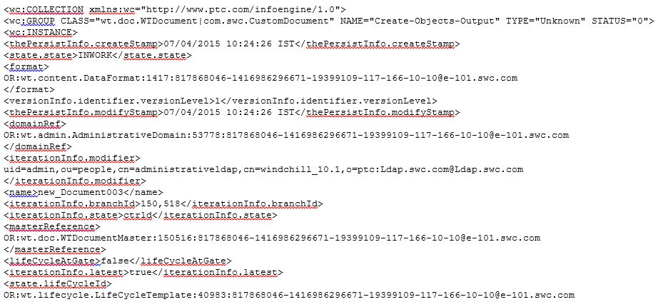

Apr 6, 2015 5:47 PM UTC
Apply-Service webject will returns object(s) returned by (Java) method it calls in turn (if its not void). You can use those objects by casting from "Object" to appropriate class. If you provide a few screenshots, I can be more specific.
Neo1-VisitorAuthor
Apr 7, 2015 5:25 AM UTC
Hello Yogesh,
Basically I am new in Info*engines so I am pretty not sure how this can be achieved so I have call it in that way
first I call the webject xml using this method
String url_open ="http://hostname/Windchill/servlet/IE/tasks/ext/swc/object/createDocument.xml";
java.awt.Desktop.getDesktop().browse(java.net.URI.create(url_open));
once the code is execute it open the file in the browser but since I have open it in through the url I am not able to get the group object
this is my webject task:
<%@page language="java"%>
<%@taglib uri="http://www.ptc.com/infoengine/taglib/core" prefix="ie"%>
<ie:webject name="Get-Properties" type="MGT">
<ie:param name="ATTRIBUTE" data="wt.federation.ie.VMName"/>
<ie:param name="GROUP_OUT" data="properties"/>
</ie:webject>
<ie:webject name="Query-Objects" type="OBJ">
<ie:param name="INSTANCE" data="$(properties[0]wt.federation.ie.VMName[0])"/>
<ie:param name="TYPE" data="wt.inf.container.WTContainer"/>
<ie:param name="WHERE" data="name=Swc_Product"/>
<ie:param name="GROUP_OUT" data="container"/>
</ie:webject>
<ie:webject name="Create-Objects" type="ACT">
<ie:param name="CONTAINER_REF" data="$(container[0]obid[0])"/>
<ie:param name="TYPE" data="wt.doc.WTDocument|com.swc.CustomDocument"/>
<ie:param name="FIELD" data="name=new_Document003"/>
</ie:webject>
