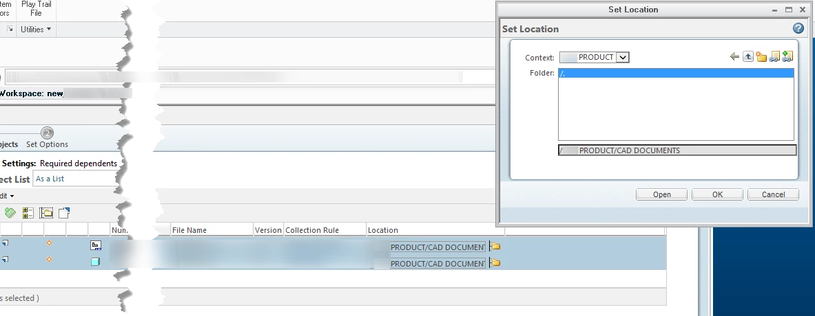

I would like to change the default Set Location directory from PRODUCT/CAD DOCUMENTS to a different folder location for new files.  I'm having a terrible time attempting to locate the information to perform this operation.  We also have a CAD STANDARDS context (if it matters).
Attached image for reference.

Hi Mitchell,
You can Edit the Workspace Preferences and Set the Default target Folder.
Nov 10, 2016 3:02 PM UTC
The default folder is defined for each object type in the Object Initialization Rules. Look in the online help for examples.
If set on Site or Organization level, they will be applied to all your users.
