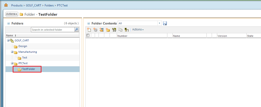

Using data utility you can render different Icon in PDMLink product folder structure if it's empty.
In below snapshot "TestFolder" is emplty that why the icon is different.

I guess you cant change the colour as its a icon.
To change the color you have to replace it with a same kind of icon where the color is red.
