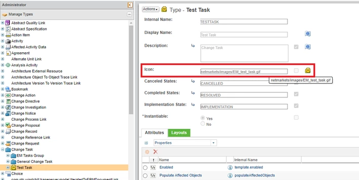

Your administrator should be able to do so in the Type and Attribute management
Also there is possibility to customize the icon base on some rules by a code.
CS216205 - How to display a different icon for a soft type of WTPart

I created a folder for all of our company icons then make the change in the Type and Attribute management page.
I also created a company sub-type under documents and then put in our document types as sub-documents.
Everything is easy to identify for what we have added to Windchill types.
