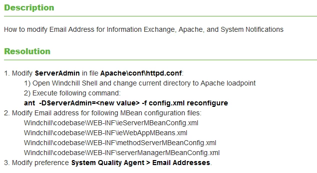

Hi
i started approval promotion request
and windchill send email to aprrover or reviewer
Can I change the address for windchill to send this email?
How do I change it?
Do I need to configure and change SMTP?
It seems to be the email address I registered at the time of installation or the email address of the site administrator.
If I do not configure SMTP on Windchill, will not my notifications be sent?
Thank you.
I do not have enough explanation, so let me add one more.
Can I change the email address for system notifications I entered when I installed Windchill?
[Assuming you have configured SMTP]
How do I change it?
November 28, 2017
CHASEONHO18-OpalAuthor
18-Opal
December 19, 2017
Where is System Quallity Agent?
