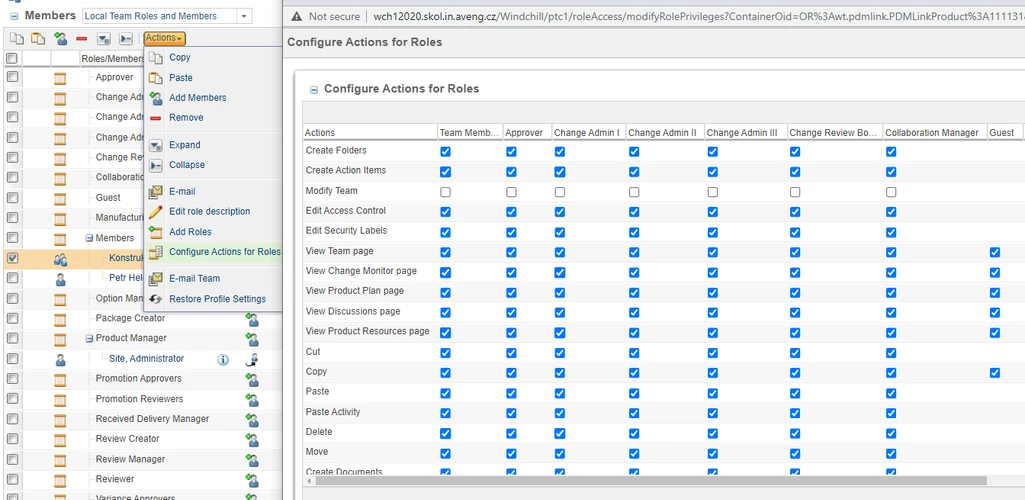

Hi @OnurNalbantoglu
Try to do so from context / product / library team
There you can change the profile setting based on the roles of the context.
Can not find any better way now.

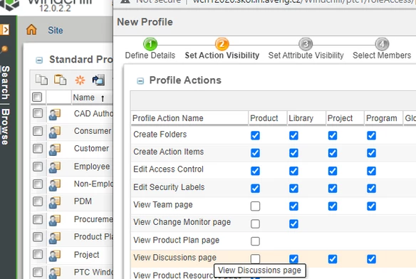

Hi @OnurNalbantoglu
What do you mean combine? Try to explain what you need.
PetrH
Sep 12, 2022 7:16 AM UTC
I want to show users only the folders element from the lists under the package
HelesicPetr
Sep 12, 2022 7:26 AM UTC
@OnurNalbantoglu
Try to use Profiles.
Create own profile and add users to it
Set the visibility of product list to not show what you need to user.
You need to find all functions to hide them.
I guess that almost all you can hide to the users
