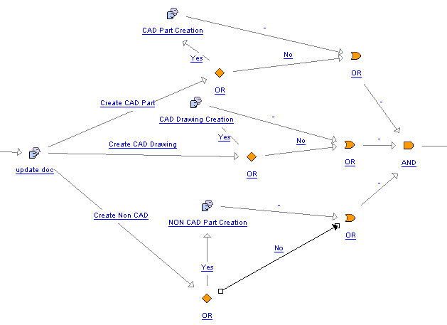

but when I am completing the task workflow gets terminated, I am trying to move it to another activity is it possible to do?
Jul 18, 2016 2:06 PM UTC
A D‌,
Do you have a routing for the activity, can you send me a screen shot of the process manager.
Bhushan
adev-21-VisitorAuthor
Jul 19, 2016 2:48 AM UTC
Hi Bhushan thanks for your reply,
this is how it looks like I have 3 options to perform Create CAD, Create CAD Drawing or create Non CAD, when I try to complete the update doc it terminates the process
