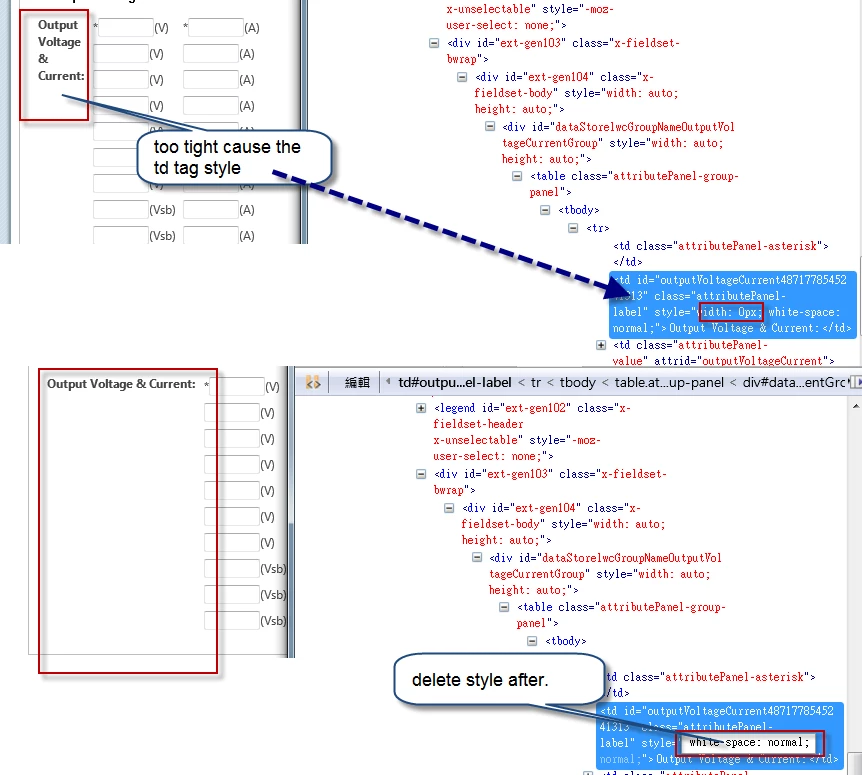

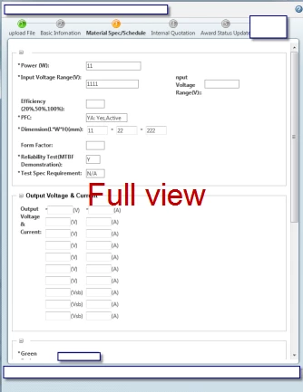

How to configure AttributePanel width value when customize a AttributesComponentBuilder?
dear all
I encounter a cusomization prolbem with AbstractAttributesComponentBuilder for build a wtdocument in wizard step.
After I configure universal language . The html table sytle is not as expected.
This is piecess source code.The attribute attach customize dataUtility.

I also try to disable all customlize.The result is same.
How can I do to delete the style value ?
