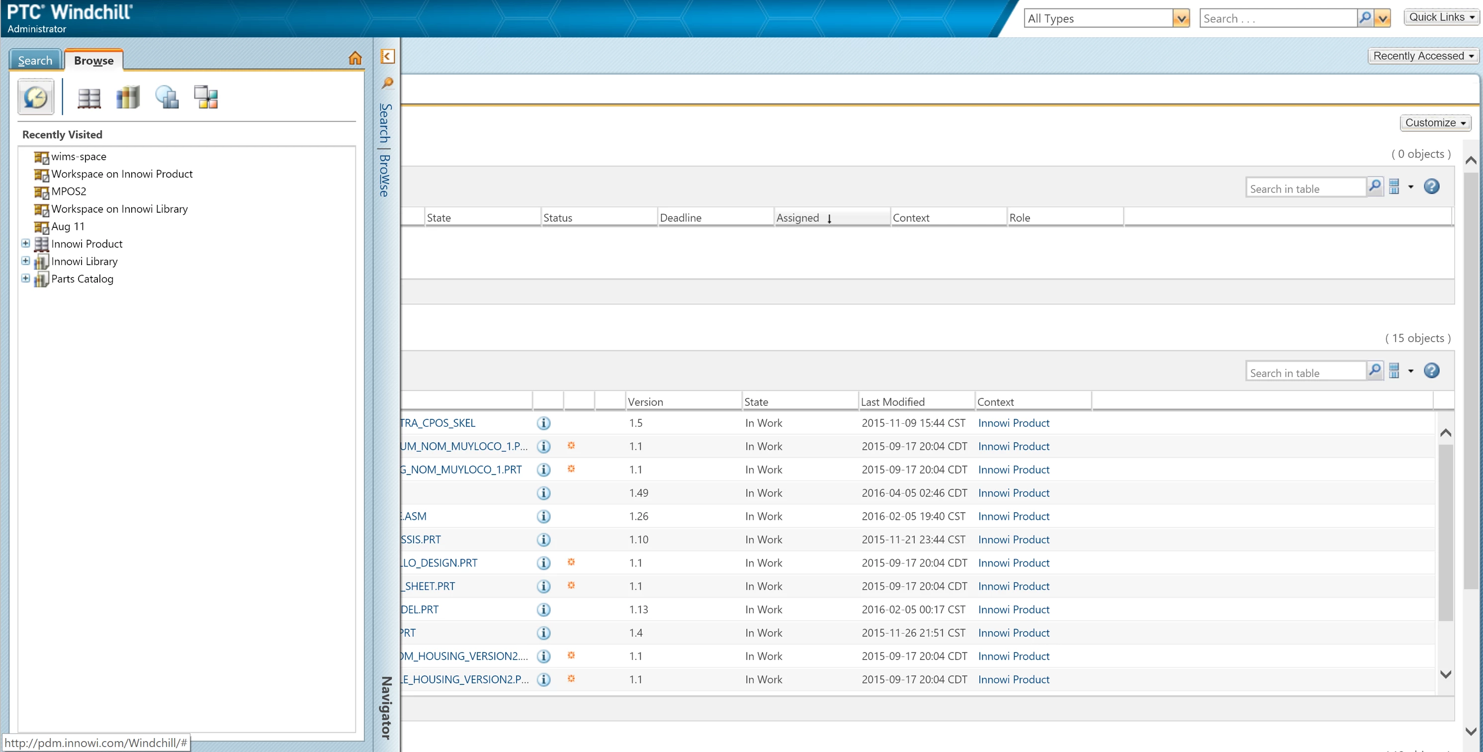

I have purchased a Creo Advance with PDLM - Locked, but I am having hard time to access my company's Server (WindChill). They need to create a new account for me, but the system is not allowing them. Not sure how can I go about this. See the photo attached for how the WindChill looks like from our end, which is different from other. I have been told, other can easily create a new account. Please advice.

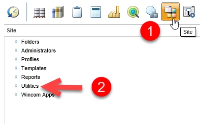

Looks like you have Site access
1. Select Site
2. Select Utilities

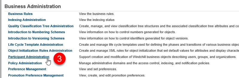

3. Select Participant Administration

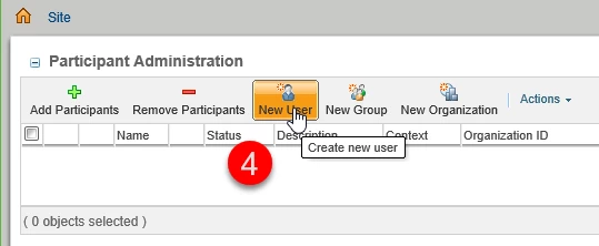

4. Select New User.
