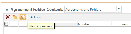

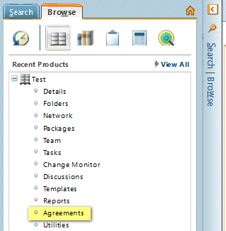

Feb 17, 2017 2:02 PM UTC
Hi Aditya,
You should see Agreements in the product container, the link takes you to the Agreement Folder, and that's where you find the New Agreement button. so A policy is also needed for the user to be allowed to create that type, or just put him in the product manager group to test.
Regards
Rob

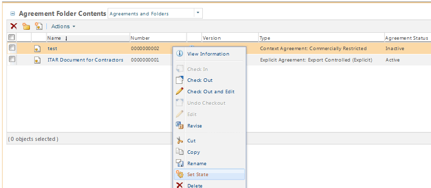

aachanta15-MoonstoneAuthor
Feb 20, 2017 4:19 AM UTC
HI Rob,
Thank you. I had created an agreement. However it is in Inactive state.
How to make it active ? Can you please let me know about it ?
Thanks and Regards,
Aditya Achanta
rhart16-PearlAnswer
Feb 20, 2017 9:26 AM UTC
Hi, if the user has the right access, they can set state.
Regards
Rob
